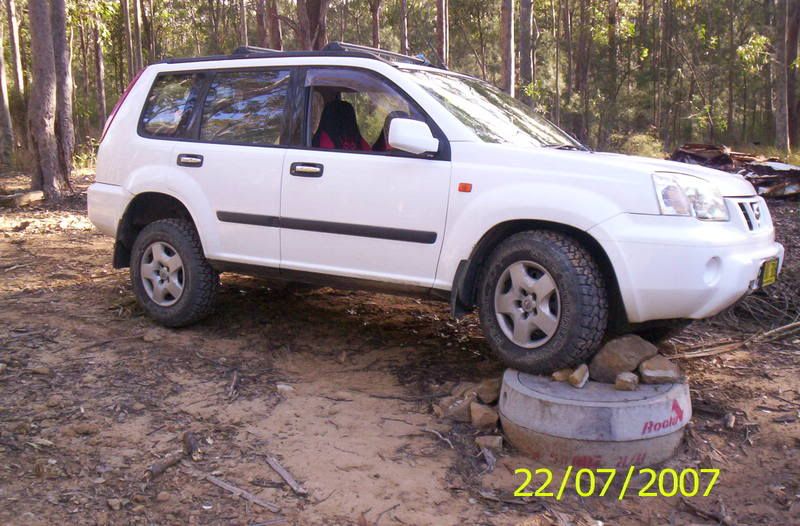

Nankang Wide Conquror A/Ts around the $145/tyre very good tyres heaps of tread lots of grip
I had them in a 215/75R15 on my xtrail for 2yrs ith lots of off rd abuse
no cuts or chips never staked they loved the mud & rocks gave plenty of grip on tarmac the only place they weren't too good was on stockton as they have a very open self cleaning V shape tread & they dig down to get traction off rd which is gr8
they are very good touring tyres as well did lots of interstate travelling with them on tarmac & out back tracks including bulldust in the 2 yrs I had them they only wore down 3mm from 14mm

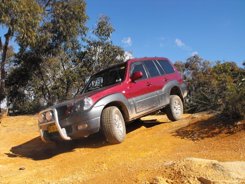

I can also recommend Delta Serradial A/Ts I currently have a set of these on my Terracan & just love them even more that the Nankangs
